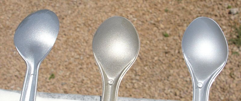

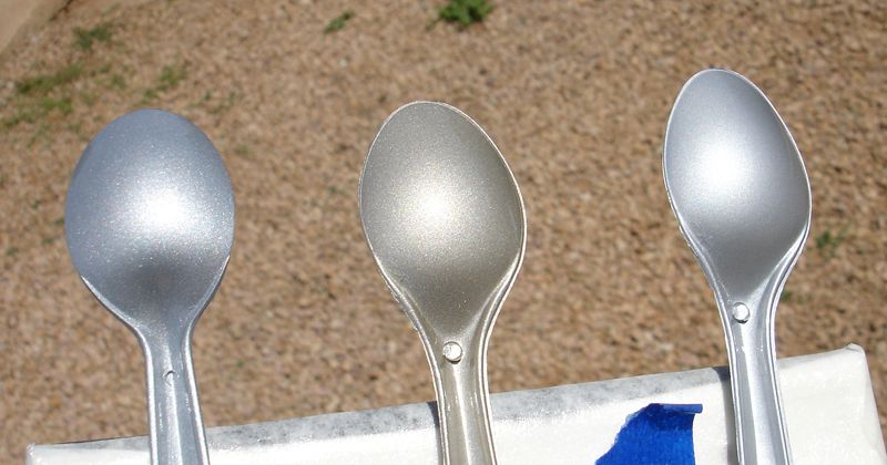

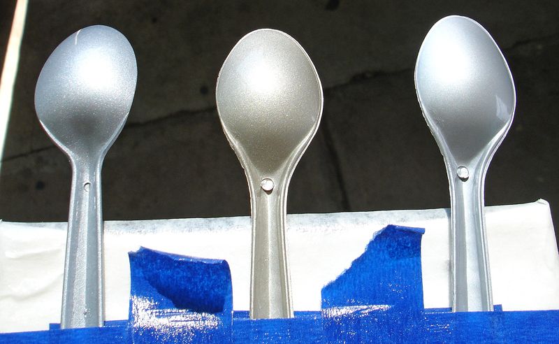

Yeah TS-30 will be the one I reckon.
It will change again when clear coated. Do that today.
Not one ray of sunshine outside to day, so much for showing in natural light. :x
Re: going for second place.... silver!!
Still havent applied the clear
TS-88, TS-30, TS-76
TS-13 clear applied. about 3-5 coats.
TS-76, TS-88, TS-30
;) thumbsup
Yep definitely TS-30! :) thanks so much mate

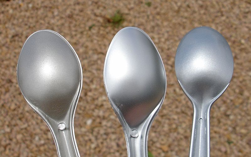

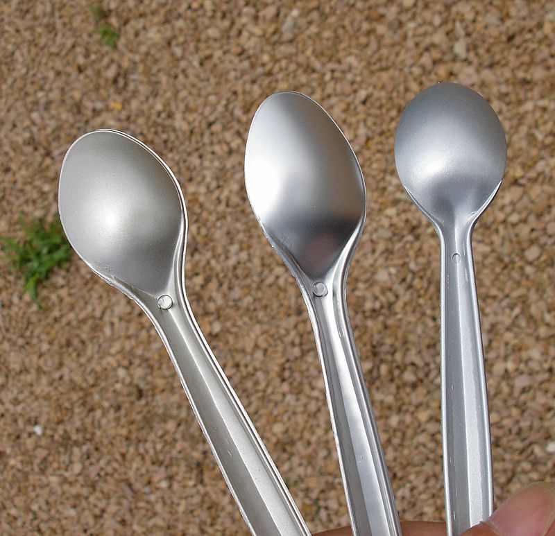

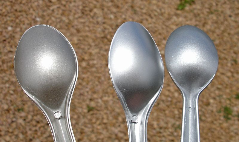

So I clear coated the green/blue I did.. still not happy with the colour, mixed a custom colour and still not happy.
but anyways... clear coated and the silver leaf wen white :/
pullinghair
Im guessing here, but maybe you went a bit heavy with the clear.
Got to sneak up on the paint at first just super light coats and let them dry.
Got to be patient when using TS-13 its finicky sometimes
That is a first thought Luke but this was a really light mist coat, i waited 20 minutes and went back to do another mist and found this had happened.
Wondered if it was the amount of moisture in the air as last night was a crap night, still 30 odd at 2am.
But this was in the fan room at work which is always perfect for painting so i am at a lose.
I plan to redo the torquoise, once I am happy with that, I will re do the white sides and black roof, clear coat all that, then do the silver leaf. altho that does worry me since I don't want to do all that and then have it go white again when i clear coat it all with decals on :/

Maybe try normal silver under the silvers so if it "dilutes" there is still silver under it to help keep it solid?
You will have to clear coat before the decals, better to find out before decals.
